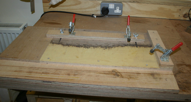

I use an old record No 5 Plane and a shooting board, I have made one with Toggle clamps all round, as I like the material to be held really firmly.

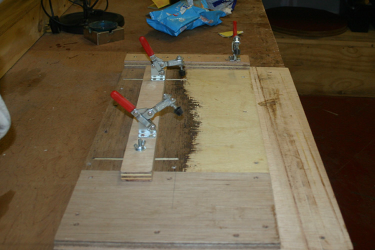

Thought I would post a couple of Pics of my shooting board , the side bar moves in and out for different widths of board and is locked via the wing nuts.
